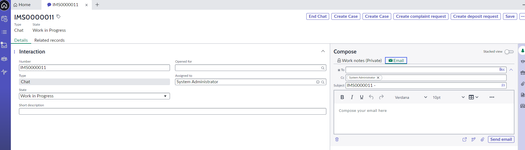

How can i add email to compose tab for interaction table in custom workspace

This is not email client ,this is an mini email composer i tried it already and looking for option in compose section of record page as shown in images
