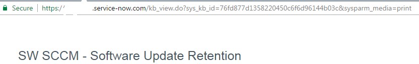

When I hit the print button it opens the KB Article in new window with "&sysparm_media=print" parameter as below-
But after this it does not automatically opens the print button.   I added the alert in script tag but no message was displayed.
