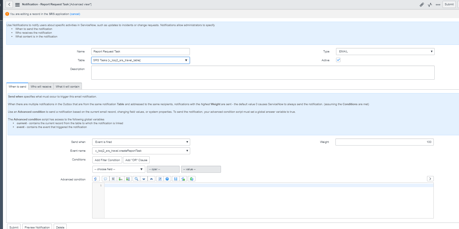

I'm trying to add a LINK to RITM inside of my email notification. I tried the following but it does not work.
${sysapproval.URI_REF}

what do you mean? where is display? Do you have a picture?

On which table is this notification created?
If it's created on the sc_req_item table, you should use ${URI_REF} but if it's created on the sysapproval_approver table you should use ${sysapproval.URI} to get the embedded link.

it is a custom table..
