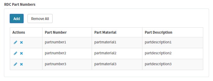

I'm hoping you can assist with an anomoly I'm encountering with multi-row variable sets. I have a Catalog Item with an MRVS which contains 3 variables - Part Number, Part Material, and Part Description...in that order.
When the request is submitted, the RITM requires 1 approval, and after this approval, a workflow script executes which parses through the rows of the MRVS and creates a separate RITM for each part. The original MRVS in the original RITM is overwritten with the part information in position 0.
This is all working as expected. The anamoly is the order in which the 3 variables appear within the MRVS. In the Variable Set itself, they are ordered Part Number, Part Material, Part Description. In performing some tests, their order appears correct until it is approved (once approved, the MRVS gets overwritten with only the first row). Afterward the order seems to be random. The order of the variables in the subsequent RITMs seem random as well.
I've attached some screenshots for clarification. Any suggestions are appreciated.
Submission Form: (Order is Correct)
RITM form prior to approval (order is correct
Original RITM after approval (Order changed)
2nd RITM generated by script (order is different)
3rd RITM generated by script (order is different than previous)
