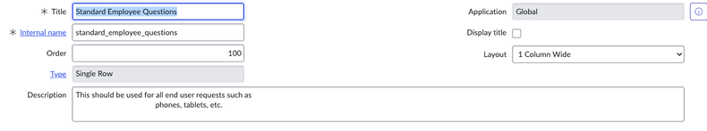

We have an existing Variable set that has a Catalog Client Script which works with the variables inside the Variable Set.
On several of the variables outside the set in our Catalog Item, we would like the Catalog Client script to work on those variables (checks will be made so that if a particular catalog item is used, we can populate those variables).
Do we need any special notation in our script to identify variables not part of the set?
