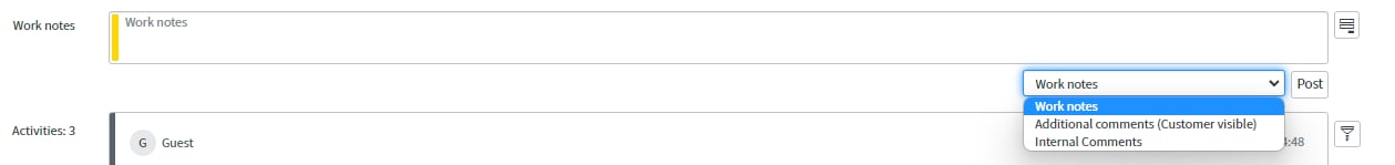

So, our setup at the moment, is that whenever a case worker post a note in additional comments, case state changes to "awaiting user". This works fine, as it often require the user to respond.
That said, there will be times when simple information needs to be shared; and state shouldn't be changed.
The idea was to perhaps add a checkbox, allowing the case worker to simple "opt out" of the functionality (see picture).
I am however having issue figuring out how the "additional comment" thing it even works. Is it even possible to modifiy it? I can't find any UI policies etc., and quite frankly have no idea how I could add another checkbox to it.

So the Work notes checkbox you see is simply just a toggle between the two Journal Input fields (Additional Comments and Work notes). Additional comments contacting the user is driven by a Notification (sysevent_email_action) for a condition of changes - like how your BR runs. If your goal is to create a new comments field that works like work notes but still customer facing, try the following:
1. Create a new Journal Input (e.g. Internal Comments) on the table
2. Edit the activity filter to add this new input using "Configure available fields"
3. You should now have something similar to below which by default does not send notifications out
4. Edit ACLs to make this new field customer visible

Oh wow, that's a great solution; had no idea you could do that.
Was afraid I'd have to duck tape all kinds of stuff together. Seems to work great, now I just have to figure out the ACLs; but that should be doable.
Total lifesaver, thank you so much 🙂
