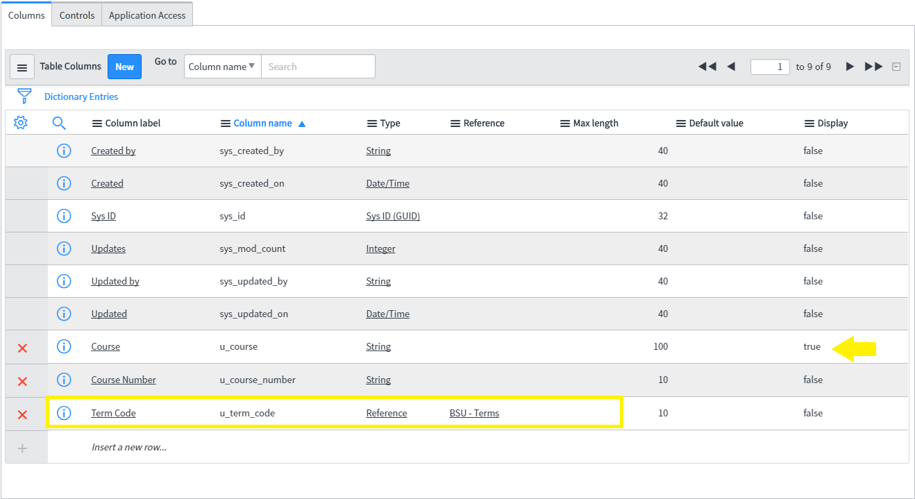

The field 'u_term_code' on the courses table is now referencing the 'u_term_code' field on the terms table, which is a string.   I re-populated the courses table to match this, but is now displaying the sys_id in the term_code field.
I am including some screenshots, below:
Consequently, adding the Advanced reference qualifier 'javascript: 'u_term_code = '+current.variables.term_req; ' under courses does not return an answer.
Is that Columns screenshot of the courses table?   If so please view the Term table and validate what dictionary entry has display = true and make sure its only set on 1 record and the value you want to show up in the reference fields.
Also look at your course variable and make sure there is nothing in the ref_qual_elements field.

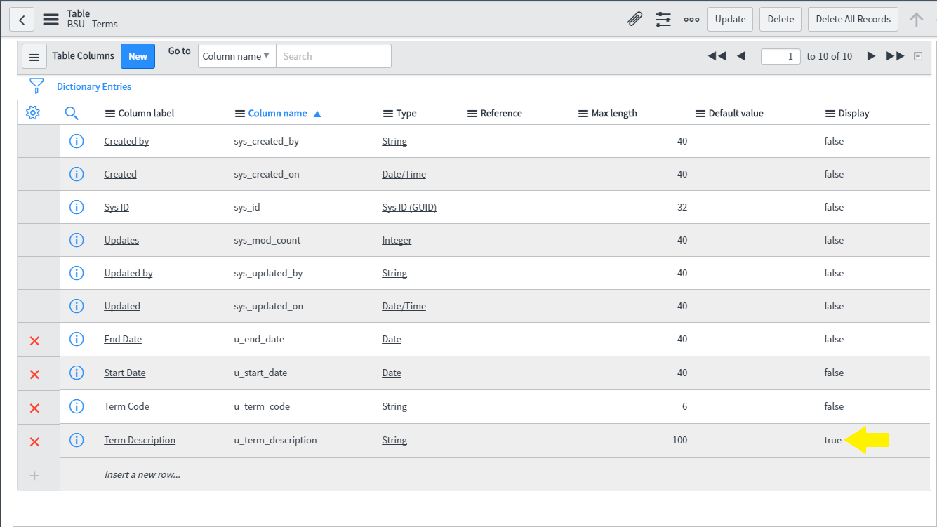

I verified there is nothing in the ref_qual_elements field in courses.   Below, is a screenshot of the terms table.   Currently, the Term_Description field is being displayed on the form.
If you click one of the term codes in this list:
Does the Term show up with the term description in your Term Code field versus the SysID?   Please also confirm that your term_req variable is also a reference to the term table.
