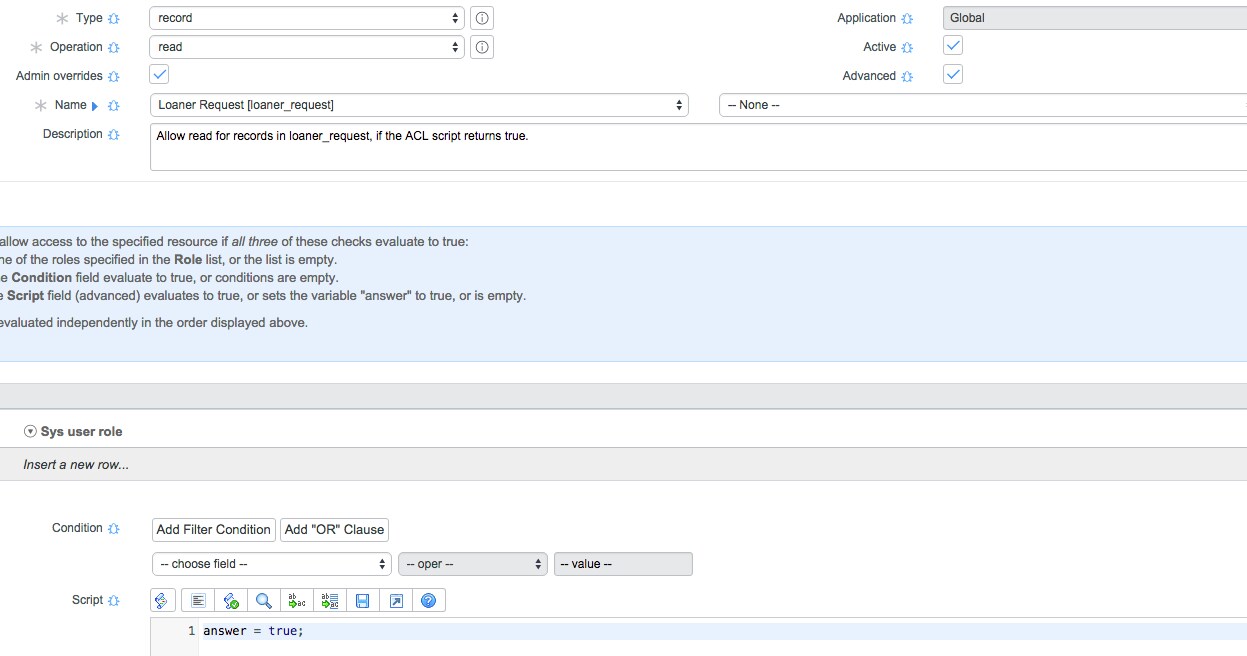

When you configure a read ACL for the loaner_request table, you are telling the system who is allowed to read those records. In the example I gave above, we were turning on read access for *everyone*. This is a common way to troubleshoot read access issues for a table- to either confirm or disprove ACLs as being a culprit. Your final configuration for this table is going to require some level of ACL to allow users to read from it. We are just trying to figure out what is currently blocking non-loaner_admins from having access during troubleshooting.
08-14-2015 04:55 PM
Hello Sorry I should have been more clear. I disabled all of the ACLs except for the Allow All to Read on all fields.
Currently there are only these ACLs on the table:
Allow All to Read, Allow All to Write, Allow All to Create
This application was built in a very old version of ServiceNow, not to mention the previous administrator seemed to create some overlapping and conflicting ACLs, that's why I had disabled all of them, and then re-added the Allow All to Read.
