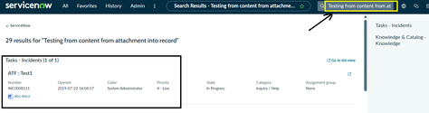

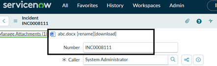

08-17-2026 09:24 AM
Hello @rajshinde999910 ,
Refer the link for detail steps :
The results will be something like this :
When attach an attachment into the record..
you can get that record from the content of that attachment..
