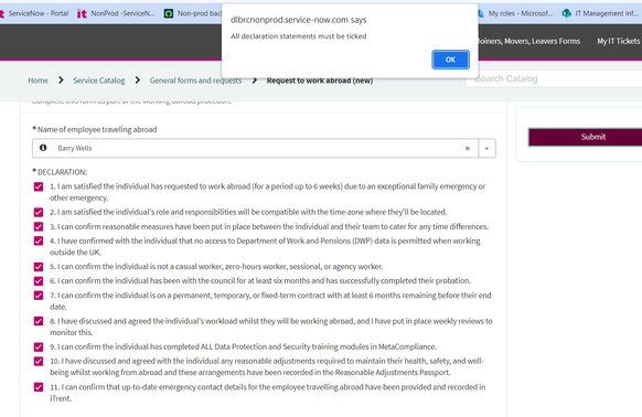

How do I make all the checkboxes "selected required", I want the customer needing to tick each of the statments or the request can not be submitted.
at the moment they are all set on " selected required" however I only need to tick one to submit the form

thank you for the reply!
I did the script, however, even though all are now marked (ticked) it still won't allow pass
What is wrong with my script?
Many thanks
Each checkbox should be it's own variable and you're going to have to check each one. Also, a checkbox is a boolean field you don't need to convert the value to a string.
