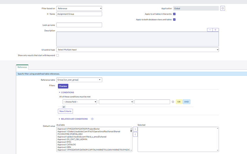

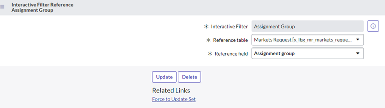

I've created a dashboard that contains a few PA widgets, as well as an 'Assignment Group' interactive filter:
The configuration details of the interactive filter are:

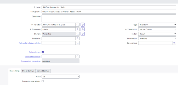

The details for one of the PA widgets are:

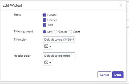

However, what I've noticed is that when I select an entry in the 'Assignment Group' interactive filter, the filter is not applied and when I click on 'Edit Widget' for one of the PA widgets, the following don't appear:
I was just wondering if somebody could explain where I'm going wrong and if it is possible to add interactive filters to a PA Widget.

Hi @AndersBGS I tried that, but unfortunately, it didn't work. I tried using a filter and making the widget follow that breakdown, but it didn't work:

Hi @AndersBGS I did try that, However, there was no option to select 'Follow Filter' when I clicked on the cog for the PA widgets.
