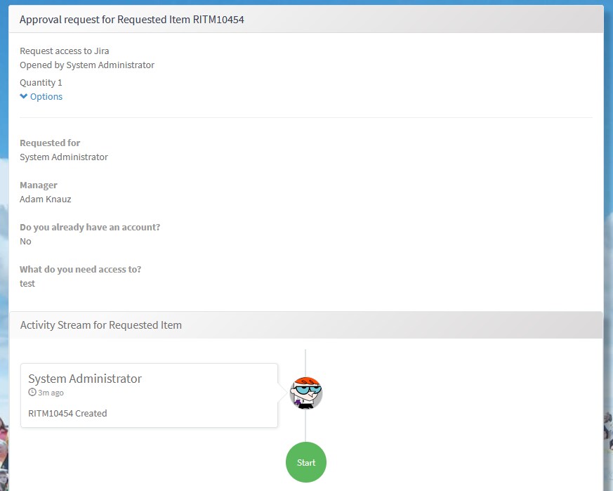

Hi Shloke,
Thanks for getting back to me.
Yeah, I just need it to work exactly like it does for the RITM, so the experience is exactly the same for the approver.
Currently, through the normal approval process, they get an email with a link to the portal to approve -
And to the right of this, they have the approve reject options -
So its just the variables they can see.
