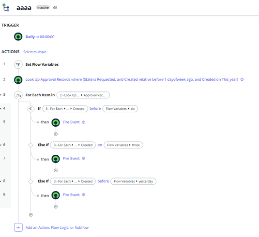

Q1)How can we achieve this by using flow designer?
Q2)Actually i have implemented by using flow. Can you please review the below mentioned flow images?
Q3)the remainder's are sending properly. but in the 8th step is through a error like as i mentioned img?

You are probably passing dot-walking the wrong thing into the record parameter on update record. Also there is not need to create an action to essentially dot walk to something you already have access to in the flow.
If I had to use flows for this use case I would probably do something like this. And avoid using waits. lauri457_0-1770342334336.png
There is no need to overcomplicate it by creating a lot of resource overhead with long running flows etc. I think process-wise it would be good to also aggregate all expiring approvals of the day for the user. I would personally much rather receive a digest email of all my approvals than multiple reminders.
It is also good to notice that the approval record has a due date field that you can utilise for this.

Hi @manojdatasc,
I have applied this similar use case; you can refer to it.
