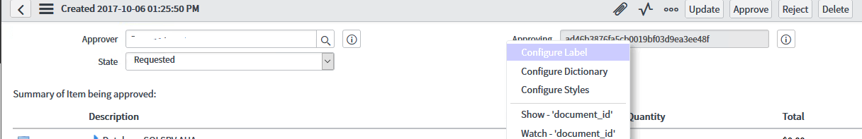

We just upgraded to Jakarta a few weeks ago and we just discovered the Approving field from the systapproval_approver table is showing the sys_id instead of the value.
I've read the current articles out here regarding the same issue and the workaround is to uncheck the Read Only field on the dictonary.
So in my situation, I've gone to the table to see if the dictionary entry was Read-only and it is not. So why is is still showing the sys_id.
I found a UI Policy that is scripted and I am wondering if this is what is blocking it. Can someone review the code below?
I have not found anything else that would force the sys_id.

Hi Karen,
There are two fields in the Approval table. one is 'sysapproval' which points to the task table. And the other one is 'document_id' field, which is a sys_id field.
If your approval is on a task table, the sysapproval field is also populated with the record ID and it will have the Number field if you add it to the form.
When approval is on a table other than task table, the document_id field gets populated, which is a sys id field.
I dont see a problem with the script you have posted. But you can deactivate that UI policy and check if it works. For me, below is how it appears for me for a document_id/Approving field
Thank you for replying Sanjiv,
        My dictionary entry appears the same. That's why I am confused as to why it is still showing the sys_id. See below:
Still not working.
Karen
Hello Karen,
The above approval record, is it attached to a child of Task table?
Kannan
