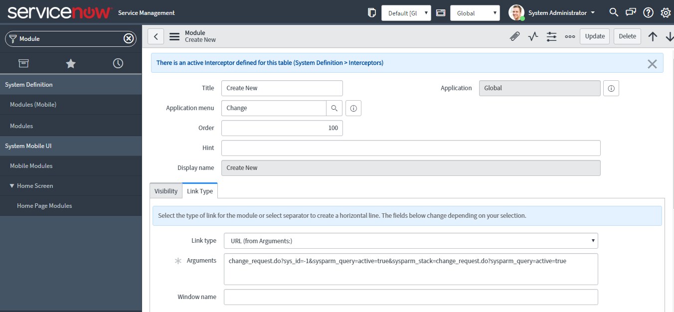

I went to System Definitions > Modules and searched for text in which I gave "Create New" and it looks like this as mentioned in the screenshot and I don't find a difference. There are other "Create New1" and "Create New2" which are not active. Tell me after this.....

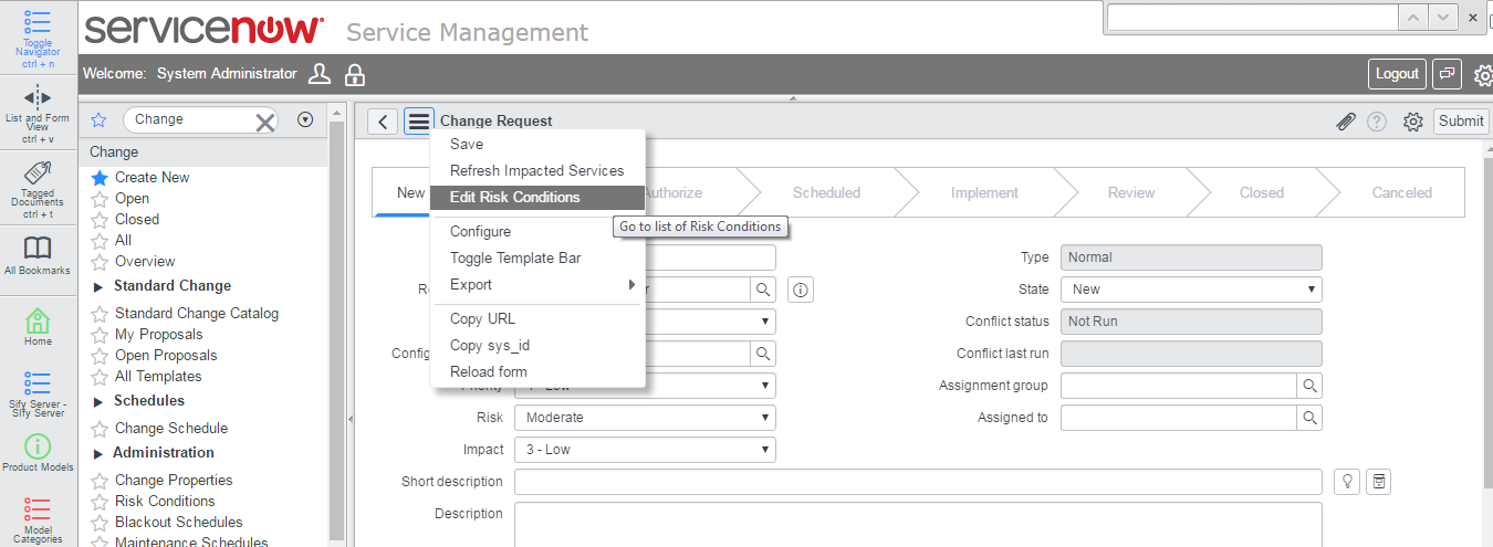

                  After switch over to UI15, this is how it look as mentioned in the screenshot.
Where can I find "change application", the "edit" option and the disable interceptor option?
here is how you will find. You have to right click on start icon then edit module
