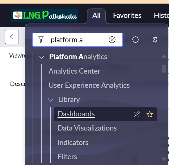

04-20-2025 11:05 PM
Hi @uttkarshupa Just to update: Legacy reports and dashboards will be phased out after the Yokohama release. The new platform analytics will be in place—and in fact, it already is. So, if you build something using the legacy setup, it might not work in the future. That’s why using Performance Analytics (PA) is the recommended option here. Also, in Data Visualization, you can create your own filters as well.
