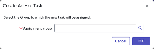

It might seem complicated but I've got several templates that I used based on what I need so it's mostly copy/paste and tweak once you have it.
The end result looks like this:

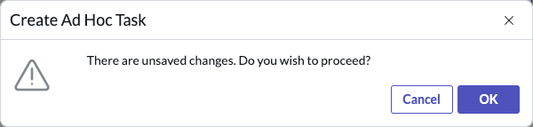

If there are changes on the form...
If there are none, or the user selected "OK" to continue...

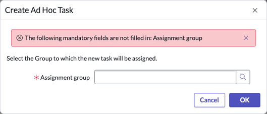

Mandatory fields are enforced
