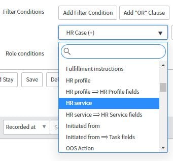

Hi Pranav,
I'm using the standard conditions, not the script conditions. See below:
So I don't have to select a 'sys_id' as I'm using the 'show related fields' and then I am shown a lookup field.
I could use the condition of the script - but I don't know the format of the dot walking to get to the field I need to from here -if you could let me know what it is I could try this?
Cheers
Carl.
hr service is a reference field
can you use the sysid of study reward application instead of name
not using the condition builder as this requires a valid selection.
