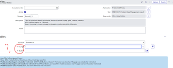

I am trying to add an ATF step (Click Modal Window) in order to click the OK button after filling in Cause notes and Fix notes for Problem's State transition from RCA to Fix in progress, not able to find the correct UI Page & Button values
is it achievable this way?
Secondly, any useful link(s) from where I can understand/implement other use cases to successfully use this step configuration i.e. Click Modal Window
Please guide.
(Screenshots attached)
Thanks!

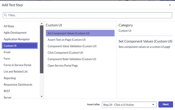

Hi Parul,
You can use below Custom UI steps:
Use 'Click Component (Custom UI)' test step
