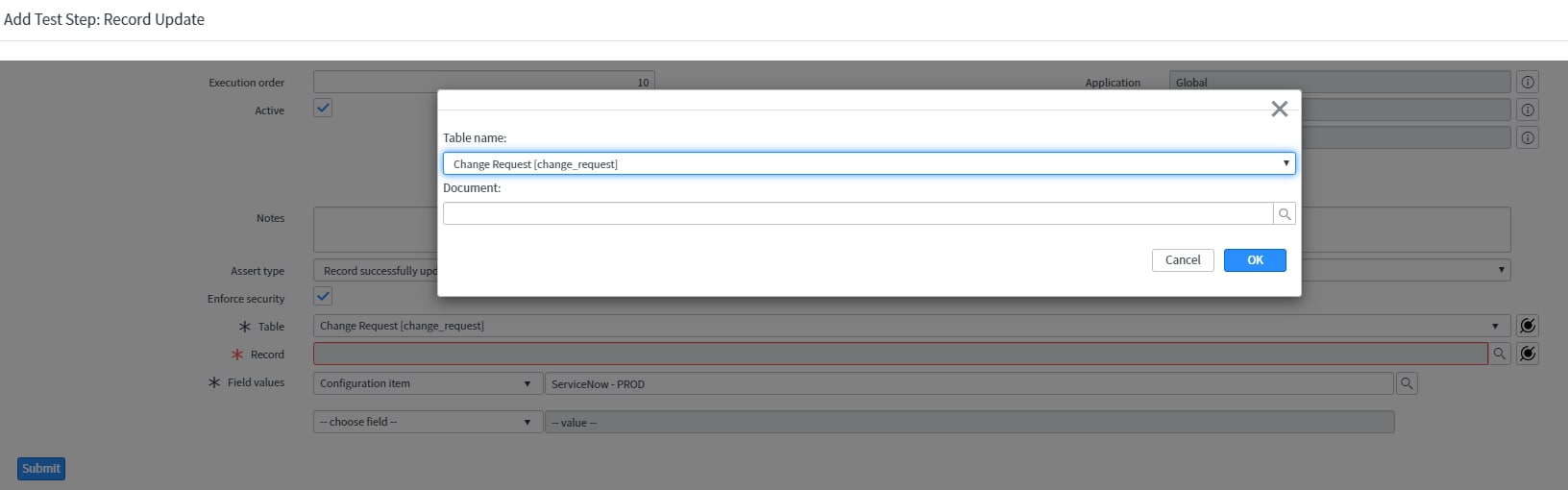

Instead of using "Set Value" step configuration, Try using "Record Update" step configurations and it should solve your issue.
For example follow the below steps:
  • Open a Form.
  • Select Record Update Step Config and update your field values
  • Run the test and should work fine.

Thanks for your response, But How can we update a record even before submitting and knowing the Change number?
