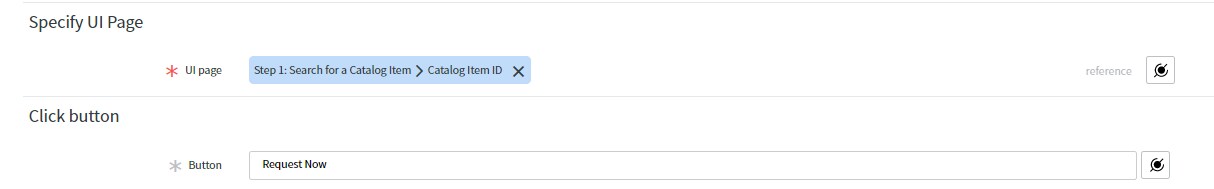

Hi Ankur,
I tried using 'Click Modal Button' step and added the reference to catalog Item ID and specified the button as 'Request Now'-
But no luck, got error: FAILURE: Did not find GlideDialogWindow or GlideModal.
Which OOB UI Page to use to get the button.
How and where can I specify the document id of the button?
