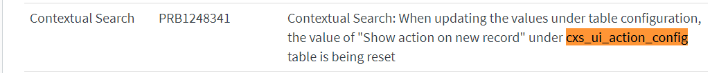

11-05-2018 11:53 PM
The table name is 'cxs_ui_action_config' .
