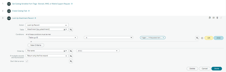

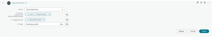

‎11-03-2022 02:31 PM - edited ‎11-03-2022 02:34 PM
Hi All. Noob here so please excuse if I am using incorrect terminology. Sandiego patch7-08-17-2022.
I have a flow that I created where I need to copy multiple attachments from the RITM when it is submitted, then attach them to an email. then send out the email to an external address. I have most everything working but the email that is sent out only attaches one file from the RITM. Is there a way I can have it loop through and attach all?
Here are the flow settings:
As you can see, from the very basic level, it looks up the attachment in the sys_attachment table and attaches it to the email. It works but only one attachment. Is there a way I can look through all attachments and add each one to the email?
