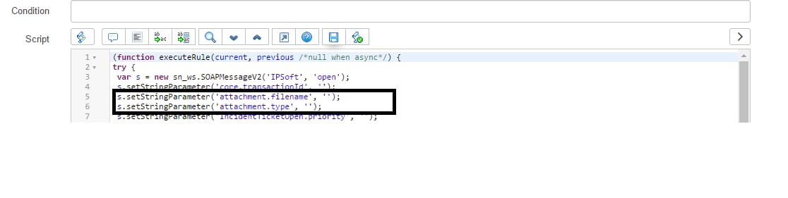

‎05-16-2017 06:40 AM
Hi Sneha,
I was able to send attachments to third party .
But, as we are using SOAP for the integration ,attachments of size greater than 5MB are not transmitted.
So, Is there a way I can call REST API's POST method in my existing business rule to send attachments.
Find the Screenshot of the BR:
Thanks & Regards
Khozema

‎05-16-2017 07:13 AM
Hi Ankur Bawiskar,
Can you rectify my code according to your script:
var attachment = new GlideRecord('sys_attachment');
attachment.addQuery('table_sys_id', current.sys_id);
attachment.addQuery('table_name', current.getTableName());
attachment.query();
while (attachment.next()) {
sendAttachment(attachment);
function sendAttachment(att) {
try {
var sa = new GlideSysAttachment();
var binData = sa.getBytes(att);
var encData = GlideStringUtil.base64Encode(binData);
var file_name = att.file_name.toString();
sendRequest(encData, file_name);
} catch (Exception) {
gs.log('Failed sending Attachment to due to Exception: ' + Exception);
function sendRequest(encData, file_name) {
//Set up variables
s.setStringParameter('attachment.filename', file_name);
s.setStringParameter('attachment.type',encData);
})(current, previous);
Thanks & Regards
Khozema
