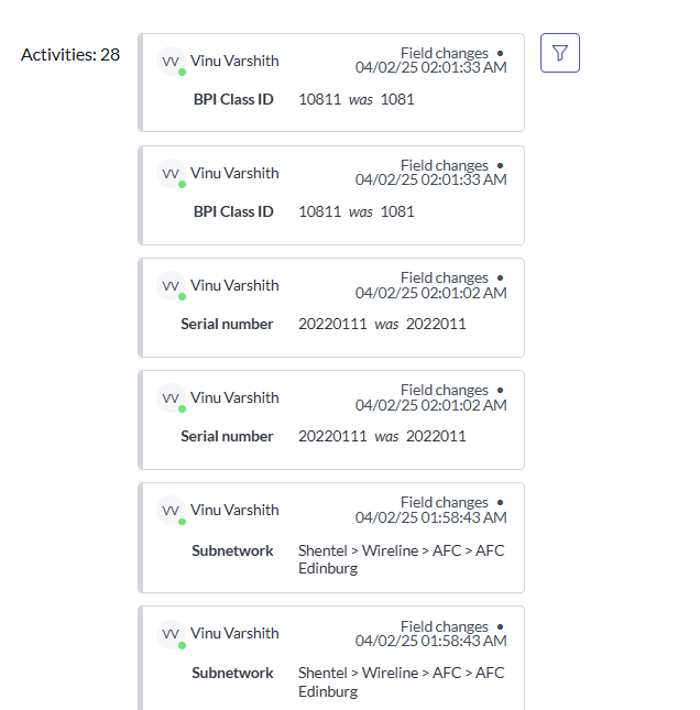

I have a CMDB-extended custom table where I have enabled auditing in the collector dictionary. When I save the form, the record gets saved, but it is saved two or three times. When I check the activities, I see three or two logs. I am not sure why this is happening. I have checked everything, including Flow Designer and business rules. I found that none of the tables have any custom scripts or Flow Designer processes running. What could be causing this issue, and how can I ensure it reflects only once? I track with help of Activates

Check any BR with 'current.update()' that could be updating it a second time.

Definitely some business rule or some script is running.
Since your table is extending CMDB, did you check any business rule from parent is running on your child table
Try to debug the business rule using script tracer
Debugging Business Rules
Script Tracer and debugging scripts
Also you can enable debug business rule details and once you save you will get to know the list of Business rules which triggered on insert
Mark
Hi @Mark Manders I have a question so if that's the case will it happen for all the attribute or for the code written to specific attribute.
Depends on the code. It is impossible to say without knowing the code.
Mark
@Mark Manders Thanks a lot tested and solved it.
