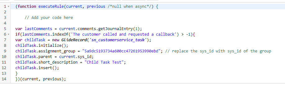

Case task still not being created. Here's the script.  Does it look OK? Syntax, etc.?

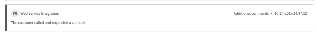

Here's what the comment looks like when it is added to the Case:
OK. I just used your script, and it worked.
find_real_file.pngNow I need to configure the script to add the 'Reason for Escalation' (u_escalation_reason_1) to be 'Callback'. And, the Priority to be '2 - High'. Also, it automatically added the 'Assigned To' as the same person that's assigned to the case. I need this to be blank/empty.
I got it working 🙂 Here's the code:
var lastComments = current.comments.getJournalEntry(1);
if(lastComments.indexOf('The customer called and requested a callback') > -1){
var childTask = new GlideRecord('sn_customerservice_task');
childTask.initialize();
childTask.assignment_group = "5a9dc5193734a600cc47261953990ebd"; // replace the sys_id with sys_id of the group
childTask.parent = current.sys_id;
childTask.short_description = "Callback requested";
childTask.priority = 2;
childTask.u_escalate_reason_1 = 'Callback';
childTask.assigned_to = 'NULL';
childTask.insert();
})(current, previous);
