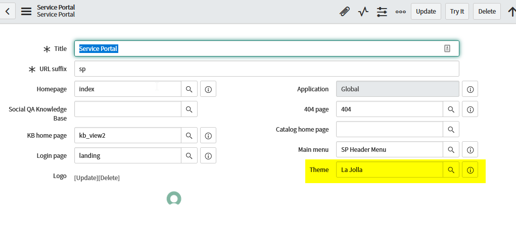

Can you tell me the steps you've taken? The screenshot seems different from the one I've posted in my steps. It seems like you're changing the theme.
As is shown in my screenshot, the background color on the portal homepage changed when I changed the Homepage background color setting.
