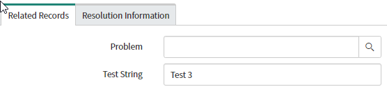

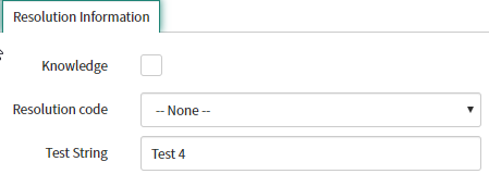

For testing...I created a string field called "Test String" and placed it under two different form sections. I'll test 2 sets of 5 saves (one set per section). First set from just updating it from the first section. Another set from just updating it from the second section.
Here's the results from each save (section 1 edit only):
And now testing from section 2 update only:
Hit an issue. Upon saving "Test 6" in the second section, the changes were not saved and refreshed back to Test 5.
Checking history log doesn't even show I attempted that change.
I wonder if it's evaluating it differently since this is the 2nd section the field is on (so last section with it doesn't "count"). I'm going to remove the test string field from section 1, leap frog over section 2 and create a section 3, and place the field from section 1...there...and now see if the behavior repeats itself with this now last section trying to be the one to make an update.
Now with trying to make update from section 3 only:
Reverted back to Test 5 as well...
Now with trying to make an update from section 2, which previously didn't "count it":
Worked.
And one more time from section 3 only...just for last ditch effort...reverted back to Test 6 text.
Now let's add it back to section 1 and see if either an update to section 2 or 3 works (maybe it appearing 3 times does something, haha):
Updating from section 3: Nope
Updating from section 2: Nope
So yea...it appears while you can add this field multiple times, the earliest section (per layout/design) is the only one where the changes will actually save.
Guess I never noticed it before, so thanks for bringing it up.
But back to the overall use case for the author...you can add it multiple times without creating a new field, if you don't DOM Manip and make it read-only...the users could think they can make a change and save. If the section the field they are viewing in is NOT the first where it appears, the changes won't save.
