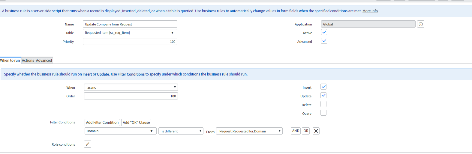

My REQ business rule is before insert or update when requested for changes, it updates the domain. That worked, then I try creating a RITM business rule before insert or update, and I have tried the condition "request changes" as well as "request.requested for changes". Neither seem to work as the domain is still based on the user who actually created the request and the business rules seem to not even run when I order a new item. Any ideas?
Remove the condition from the BR and also convert it to an async business rule.
This rule should run always if domain doesnt match the request for's domain.
Thanks, that sounded like a great idea but it is still not working. Here are screenshots of my business rule:
Any ideas?
