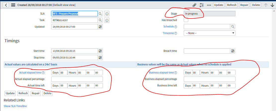

I created an SLA that must obtain results for "task_sla" records that have been created before the creation of the SLA. Therefore, I created a background script that fills in most of the fields from the task_sla record. However, I want to fill in the duration fields but I find it quite difficult. Also, I wasn't able to change the stage field from "In progress" to "Complete", because I believe there are some security rules that overpower a background script (I still have my doubts though).

Below is a screenshot that shows the fields I want to fill.

Oh, those fields. The 'Actual Elapsed Time' is calculated 24x7, no matter what. The 'Business Elapsed Time' is calculated based off the predefined schedule that you have attached to that SLA. To update them, they're expecting 'GlideDuration' values.
In your sub-production environment, create a record with an SLA you are willing to modify. Then copy the sys_id of the SLA record that's attached and use the following script to see how the numbers can be modified/manipulated:
var tSla = new GlideRecord('task_sla');
tSla.addQuery('sys_id', '<sys_id_goes_here>');
tSla.query();
if (tSla.next()) {
// 3 days, 11hr:11m:11s, you don't have to include days if you just want to change time.
tSla.business_duration = new GlideDuration('3 11:11:11');
tSla.update();

So, I guess I would need a bit more clarification on the requirements. You might also be doing redundant work in your queries which is looking like it could potentially create a lot of overhead. From the 'task_sla' table, you have access to the SLA being used, the task record (referenced so you can dot walk to task fields), etc.
Additionally, the screenshot is not rendering on my end, could you please insert the image into your response message?
