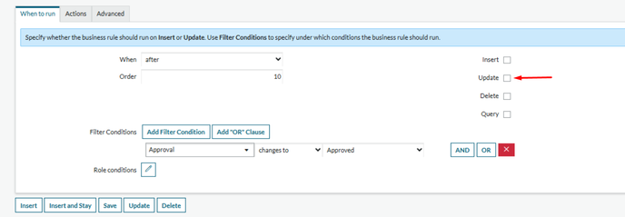

Version is Xanadu. I have a business rule on my x_1234_dlr_reemplo_third_party_admin_request table:
When Approval column value changed to be "Approved" this should trigger the business rule. However, I am not seeing proof of execution. This has the "Advanced" setting checked, so I also run a script:

My table, x_1234_dlr_reemplo_third_party_admin_request, also has a field named pin, which I am attempting to create a random 8 digit pin for, however, this NEVER gets updated after the record changes to an "Approved" state. I don't see any relevant logs that would indicate this even attempted to run.
The business rule should run whenever a record's "Approval" field changes to "Approved". I have also tried running "After" "Update" and that didn't work either.
Here is an example, viewing the list of the table records, changing the record to "Approved". Nothing happens:

jcmings
Looks like you are missing a checkbox next to Update on your business rule! You need to signal that this business rule should fire after the update is committed to the database.
