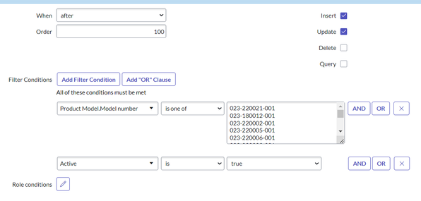

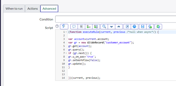

We have a Business Rule that will mark a true/false box (SM aaS/u_sm_aas) on our Account form true, if the Account has an Active Entitlement with a certain Product Model Number (see attached screenshot/s). It is marking the box true when an Entitlement is created with one of the Product Model Numbers, but if it expires and the Entitlement changes to false, the SM aaS box remains true. I've tested this with just one Entitlement on the Account. So, it didn't need to check for other active/deactivated Entitlements with one of these Model Numbers.

The Entitlement table (service_entitlement).
The BR is configured for insert and update. At least those boxes are checked on the BR (first screenshot above). The thing is, the Account can possibly have 5 Entitlements with each having a different Model Number that's mentioned in the BR. One of these Entitlements can expire (Active = false), but the other Entitlements still match the conditions, so the SM aaS box should still be true. So, the SM aaS box will stay true until there are no more Active Entitlements with one of the Model Numbers mentioned in the BR.
I figured when the Entitlement expired and Active changed to false (an update), the BR would run. But, when I tested against an Account that only had one Entitlement that had one of the Model Numbers in the BR and I deactivated it, the SM aaS box didn't change to false like it should of.

Well right away, when the entitlement expires the rule won't trigger due to the filter you configured (Active = True). After this change, your script will only update the account records u_sm_aas field to true. If you want it to change it to false as well, you will have to add the necessary logic for it.
ā08-17-2023 12:28 PM - edited ā08-17-2023 12:29 PM
To start, I am assuming you have the table for your business rules set as the Entitlement table, if so I would change the Filter Conditions in your business rule to remove the Active is true filter, otherwise when an entitlement expires, it will not be picked up by the business rule because it is no longer active. Instead lets incorporate this logic into our code.
The code would like something like:
// Create Variables
var allEntitlementsActive = true; // We will assume that all Entitlement are Active by default
var account = current.account; // Get the sys_id of the related account
// Query the entitlement table for any inactive record related to the account
var gr = new GlideRecord('entitlement_table_name_here');
gr.addQuery('account',account);
gr.addQuery('active',false);
gr.query();
if (gr.next()) {
allEntitlementsActive = false;
// Get the related account
var gr1 = new GlideRecord('customer_account');
gr1.get(account);
gr1.query();
if (gr1.next()) {
// If no results were found earlier, this will be true otherwise, it will be false.
if (allEntitlementsActive) {
gr1.u_sm_aas = 'true';
} else {
gr.u_sm_aas = 'false';
gr1.setWorkflow(false);
gr1.update(); // Update the record
})(current,previous)
NOTE: This code is untested, so results may vary.
I would try this and see if it does what you are looking for.
