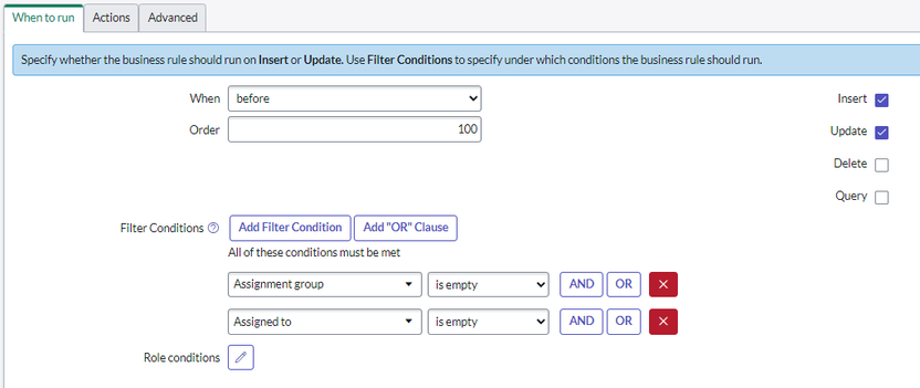

I discovered that the assignment group was being set to a different group than the one specified in my script and I identified a business rule that is setting this on insert/update (looks like it is setting a default group when the assignment group field is empty):
	//Read location of request
	var loc = current.location;

I tried to set the BR to run after insert/update but that breaks the function of the rule and it no longer works as originally intended.
How can I get the rule to work as intended while allowing the assignment group to be set through my script?

It seems like this other BR should not be running because before insert the AG is not empty, but if you're sure it is the culprit then that could be explained as timing issue.  One thing you can do on your script is add this line before the taskGr.insert();
taskGr.setWorkflow(false);
This will prevent any Business Rules from running when the record is created.

Hi Brad,
I agree but am hesitant to deactivate the rule as I did not add it and want to avoid any undesired results.  If I understand, this rule will always run.
I did add that line and it fixed my issue.
Thank you!
