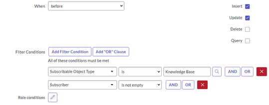

I have a Business Rule that trigger an email notification for a list of users > The Owner and the Managers of a Public Knowledge base
the conditions:
I am trying to dot walk into it, but it is not working
