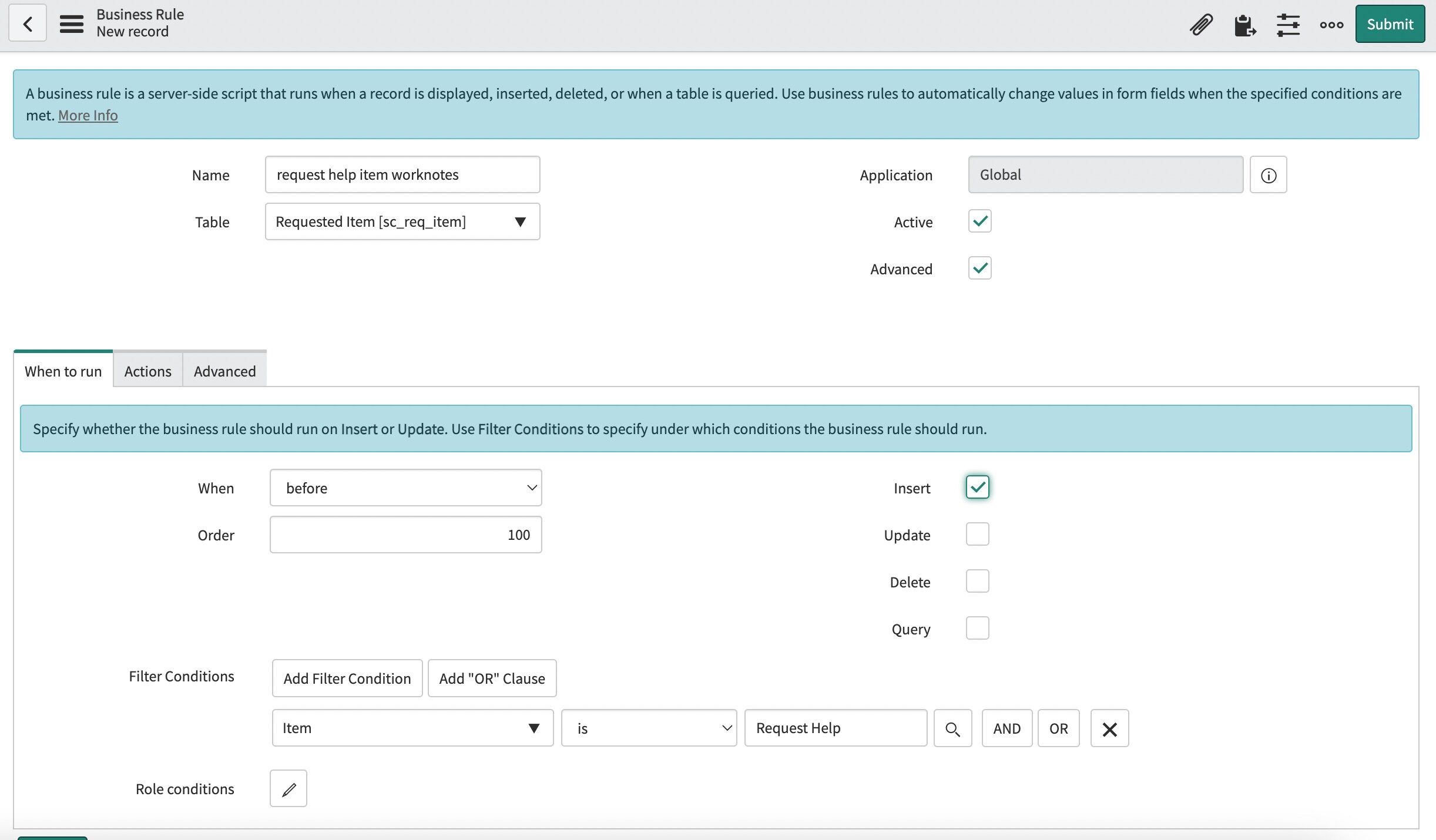

I have a catalog item in our Service Portal called Request Help. In this Request Help catalog item we ask for a reference ticket number. This reference ticket number would be an existing ticket in our ServiceNow instance. When a new Request Help catalog item is submitted I want to write this new ticket number into the reference ticket work notes.
I am able to do this in a Flow, but there is already a Flow attached to this catalog item.
So I think I need to do this with a business rule and a custom script, but my business rule script skills are minimal at best. Can anyone give me some tips, resources, or examples that might help.

I am assuming you want to copy the RITM number of the new request help item into the related incident's worknote field.
Business rule:
Script:
var incident = current.variables.ticket; //replace 'ticket' with name of your ticket reference field
var incidentGr = new GlideRecord('incident');
incidentGr.get(incident);
if(incidentGr){
incidentGr.work_notes= ''+current.number;
incidentGr.update();
})(current, previous);
Hope this helps.

var ritm = current.variables.ticket; //replace 'ticket' with name of your ticket reference field
var ritmGr = new GlideRecord('sc_req_item');
ritmGr.get(ritm);
if(ritmGr){
ritmGr.work_notes= ''+current.number;
ritmGr.update();
Let me know if any issues

The script is trying to create a new RITM to update rather than update an existing RITM. Is that possible?
I am guessing the new RITM is created by the "new GlideRecord" statement. Yes?
How do I find an existing?
