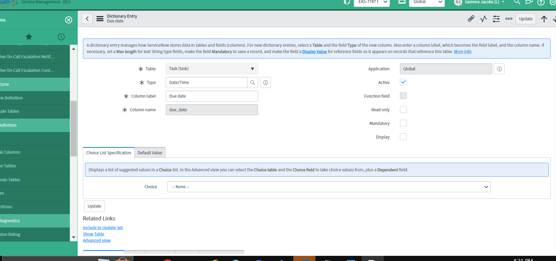

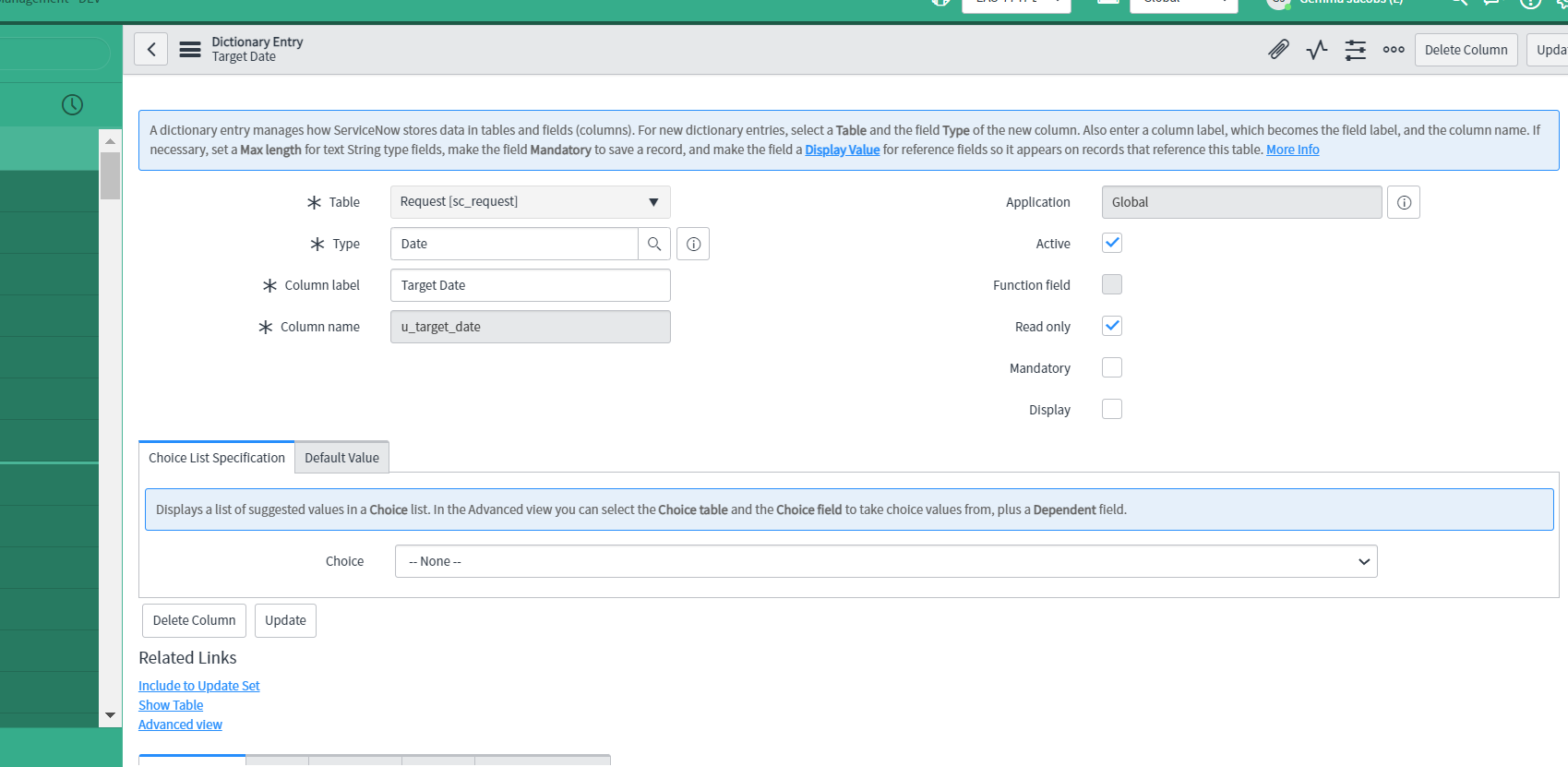

Target date is u_target_date on sc_req_item and due_date is on task. Attached are a few screenshots to help

you have 2 target date fields(sc_request and sc_req_item) if I refer to your screenshots.
now question is which target field do you want to set as due date from task?
Once you finalise then you will need 2 BRs (one on sc_task and one on sc_req_item) both will run after insert.
then just write following in script of BR:
current.due_date = current.request.u_target_date;
current.update();
