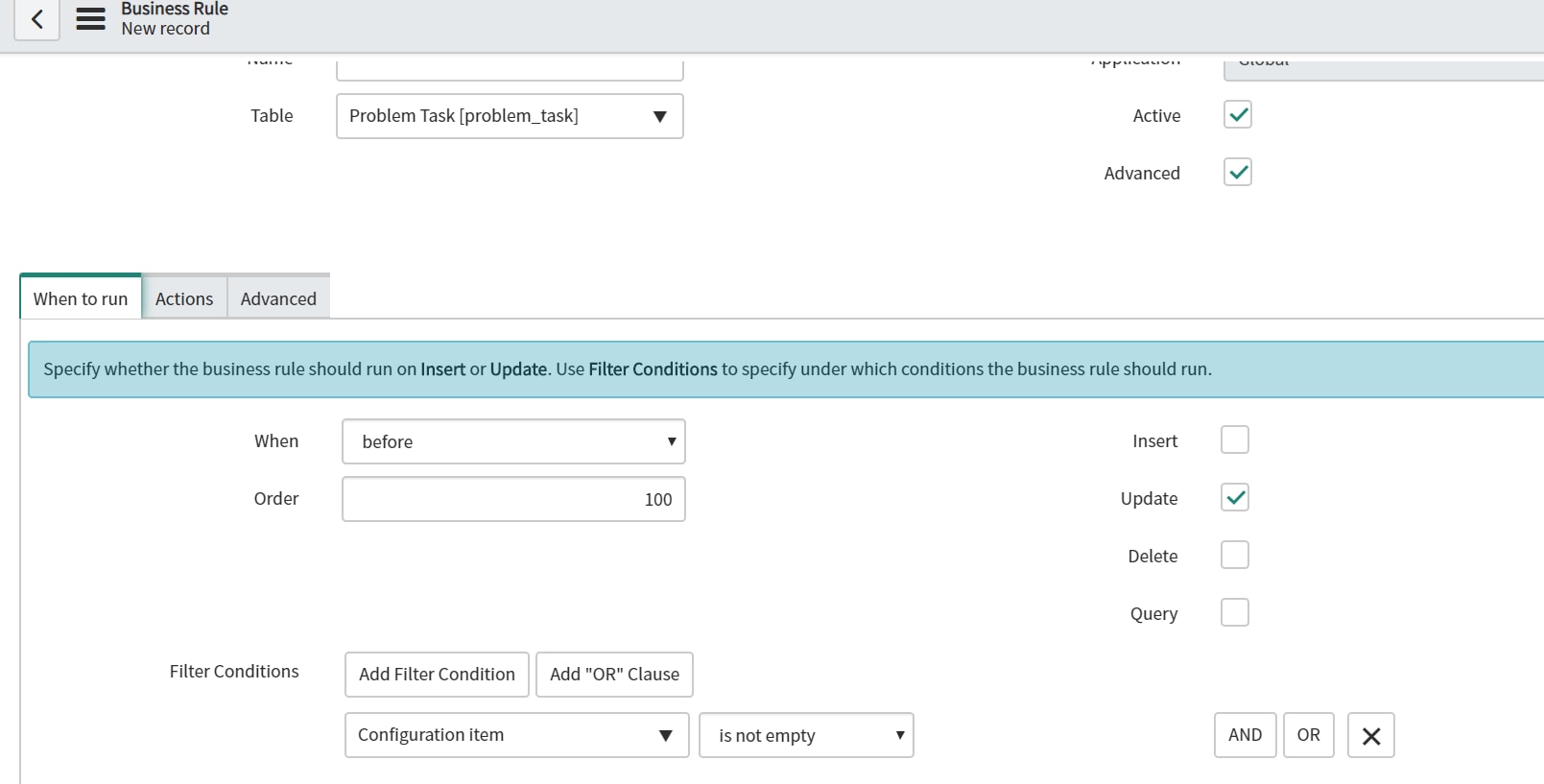

You dont have to have this complex,
Make the business rule as before update and add condition related incident is not empty ,like below screenshot (i used configuration item field, as i dont have that field in my PDI)
And this is in script
