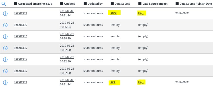

Why are some fields clickable in list view
Shannon Burns
For one particular table I created, there are columns that are clickable that shouldn't be
I don't want them to click on the data source or the impact - they only bring up these screens which are not helpful.
For ex: this table looks normal, where you can't click to select the columns for type, likelihood, etc.
I'm just not sure what I did different with this table that they are acting this way when other tables are not.

Another option is to dot walk to the string field instead of using the reference field in the list layout. You can right-click the header --> list layout --> remove the reference field, click the reference field, click expand in the center column, and find the string field name. For example, expand data source and select data_source.data_source as the sub-item.

Hi, You can remove link in the list view by going into the list control. Right click on the list header go to Configure -> List Control and check the Omit Links checkbox Mark it correct /helpful if it helps you Regards Ravi

But that gets rid of all the links, I would still like the links there to open the record (from the updated column) and the link for the associated emerging issue in case they want to open that issue.
Do you know how I just remove the other links?  I really have no idea why this table acts so differently than others I created.

When you remove all links, you can still use the little blue i to open the individual rows.

Reference fields will typically be links on the list view. If you want to get rid of them, you can configure the list control to omit links. This option also omits the link to open the record itself, so it may not be the best solution. You can modify the list layout so that the fields are in spots which make them less likely to get clicked or remove them from view if they aren't needed.
