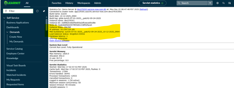

Hi @F_bio Santos  @Matthew_13
Yes, we can do read only in multi row variable set from catalog item in Zurich release.
Below screenshots mentions all in Zurich version:
