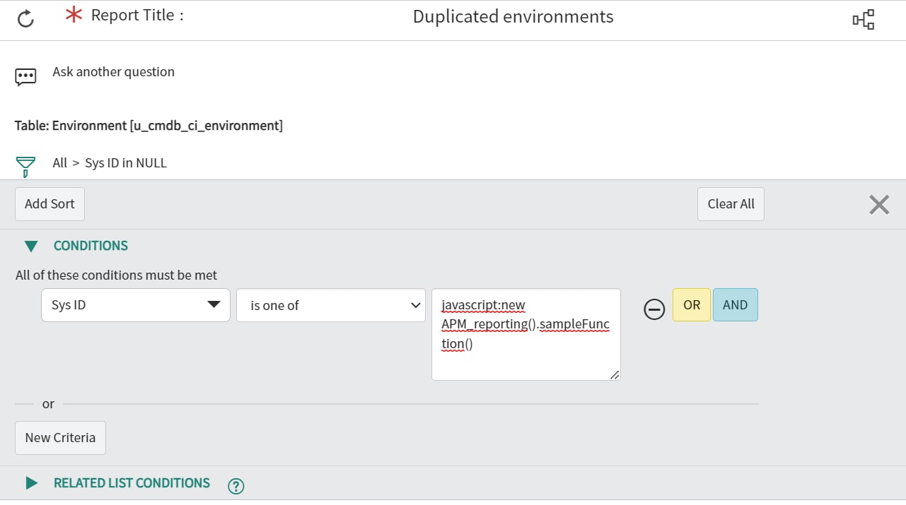

I have a written a function in script include to list all the duplicate records from table.
Tried to call the script include function in background script, got the duplicated records sys_id but when I tried to call the same function in report, it is not working and shows sys_id in null.
Below is the code:

Please refer the below screenshots for reference.
Will this json parser work when we call this function in report?

04-25-2023 11:58 PM
Hi Vamshi,
Yeah, it is returning the required sys_id in background script; but not working in reports. Is there any restriction of using json parser while calling the function reports?

04-26-2023 12:26 AM
Hi @abhi710
There should be no restriction on using a json parser in a report as long as the function has the appropriate scope and permissions to access the necessary data and resources.
It is possible that there may be some differences in how the json parser is used in a report versus a background script. One thing to check is whether the json data is being returned correctly in the report, you can use console.log or gs.info messages to output the json data to the log and verify that it is being parsed correctly. Another thing to check is whether the function is being called with the correct parameters and in the correct context, just ensure that any variables or objects that the function relies on are available in the report context.
