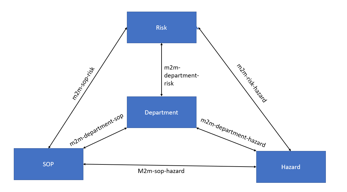

A strange one for you.
I have four tables Risk, Hazard, SOP and Department that are joined together by six m2m tables like this..
Which all seems to work and do what we want it to do.
My problem is when adding the related links to the bottom of a form.
When viewing from a Hazard Record you can see the SOP and Risk records in the list and filter buttons and New and Edit buttons work.
When viewing from a SOP Record you can see the Hazard and Risk records in the list and filter buttons and New and Edit buttons work.
But..
When viewing from a Risk record you can see the SOP and Hazard records , all of the filter buttons and New and Edit buttons are there but nothing happens when you click on them. It's like the whole tabs are dead.
We've just upgraded from Rome to Tokyo and it did this on both versions.
Anyone have any idea where to start looking. I'm assuming it's some security rule somewhere.

Sorted it.
This was a weird error. After going through loads of ACL's and security permissions I noticed that the page wasn't scrolling all the way down to the bottom.
After a bit of googling I found out something about page lengths. As the form was all just one long form I added a tab section in the form.
This allowed the form to scroll all the way to the bottom of the page. Once it did this all the buttons worked as they should.
