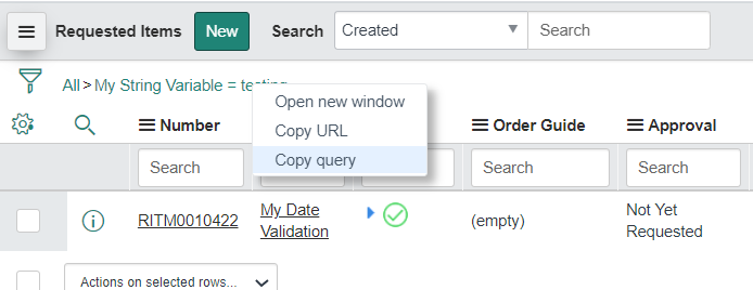

Generic Approach:
You can form the query from the table list and then copy the query and then use it
Select the Variables -> Select your catalog item -> Select your variable -> value to search
For me it looked like this
a.addEncodedQuery('variables.9415cd6f0750ec90540bf2508c1ed042=testing');
