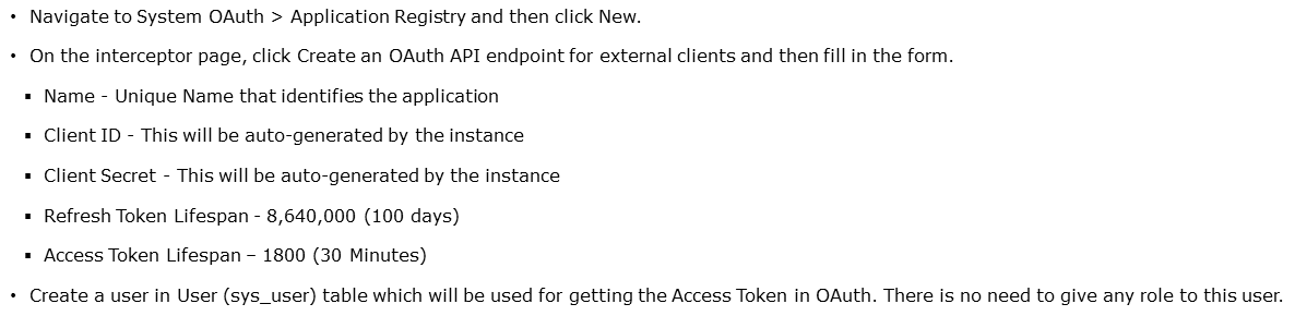

3) Navigate to System OAuth > Application Registry and then click New.
On the interceptor page, click Create an OAuth API endpoint for external clients and then fill in the form.
Name - Unique Name that identifies the application
Client ID - auto-generated by the instance
Client Secret - auto-generated by the instance
Create a user in User (sys_user) table which will be used for getting the Access Token in OAuth. There is no need to give any role to this user.
