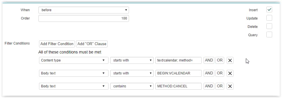

Well luckily I did! By adding the following Business Rule to the sys_email table:
Conditions:
[Content type] STARTS WITH 'text/calendar; method='
[Body text] STARTS WITH 'BEGIN:VCALENDAR'
[Body text] CONTAINS 'METHOD:CANCEL'
Actions:
[Content type] TO 'text/calendar; method=CANCEL'
Hope this works for you as well!
Cheers Chris
Conditions:
Actions:
Cheers Chris
