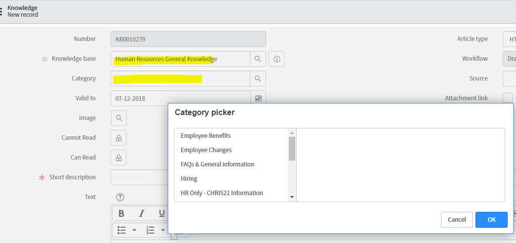

This is how it looks when adding via the plus-signs in the botton of each container (I also tried adding just 1):
When I press OK, the category is not transferred to the field on the form. When I click the search button to the right of the field again it looks faulty/empty:
I reload the form and I'm able to open the category picker again, but my "saved" values are not there.

We're on Jakarta and are having the same issue - it was working last week, but has for some reason stopped.   I found that this is caused by the fact the 'parent id' field is not automatically populated in the category - see screenshot below - highlighted in yellow.   knowledge issue1.PNG
Updating this shows the category fine, but it's a bug as it should use the one selected when creating an article, see screenshot below:
I've also found that the users try to re-add the category again and then received the following error:
Did you ever find a solution for this, or did you log a ticket?
