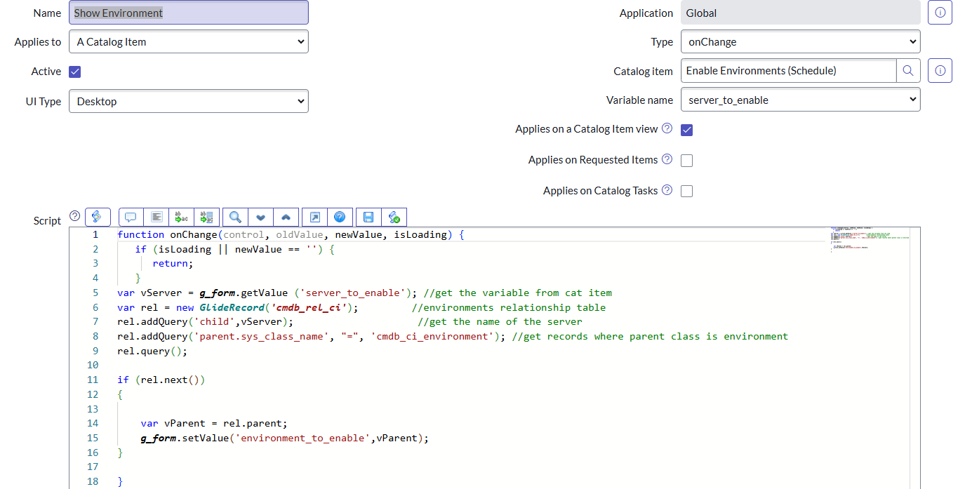

I have a requirement on a Catalog Item to populate a field based on a prior selection. I have written a script but cannot get it to function, details below:
Variable name:  'server_to_enable' - this populates a list of configuration items.
Variable name:  'environment_to_enable' - we want this to populate with a list of environments that are associated with the earlier configuration items field. (this is the field that is not populating).
I've attached the script below, thanks.

also from your image it's not recommended to use GlideRecord in client script, so you will have to use GlideAjax with script include

They are both reference fields, as below:
Variable name:  'server_to_enable' -  cmdb_ci_server
Variable name:  'environment_to_enable' - cmdb_ci_environment
The environment table is: cmdb_rel_ci
The environment field is: parent
