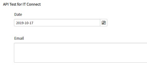

The trouble I am having is the fields displays always.  I am trying to show the field if the start_date selected is within the 2 days of today's date or if a past date is selected.
Example:
Today's date is 10/7/2019 based on our schedule, 2 days from now is 10/10/2019.  So if the users selects 10/08/2019 in the start date field then the bus_days field will display else if they select 10/17/2019 then the field will not display.
As you can see in the screenshots, both days are displaying the variable that needs to be shown.
