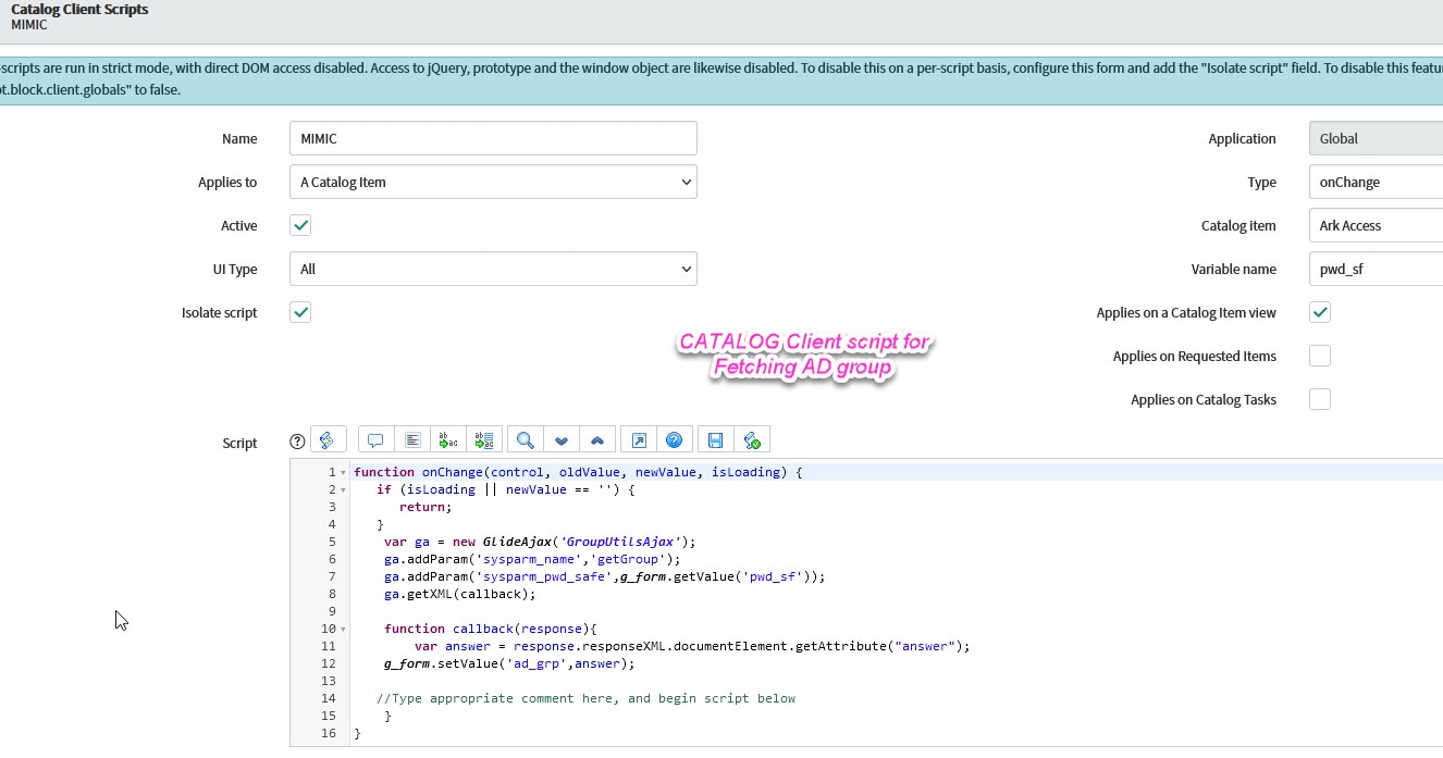

Then after some research i was able to write a client callable script include to query the groups table and populate group name in the 'Target AD' field.
Now the approval group was the portion where i had to trim the received AD group value to replace CHG /Read to MGR depending on the selection. Since that is something which i do not have to query on the server, i wrote a catalog client script and it worked brilliantly in the portal, but the same is not working in the Fulfiller view.
I mean approval group value is appearing blank on the fulfiller view.
I have enclosed the groups table values, scripts and gif for your understanding.
Below are my scripts , Please advise where can i make corrections so that it could work both on the end user and fulfuller view

‎08-14-2023 06:22 AM
Have you tried to disable 'Isolate script'?
Help others to find a correct solution by marking the appropriate response as accepted solution and helpful.
‎08-14-2023 06:37 AM
@Peter Bodelier Thank you Thank you ..very much . Unchecking the 'Isolate Script' on my populate approval group client script made the value to populate as expected in fulfiller view. I appreciate your quick reply.
