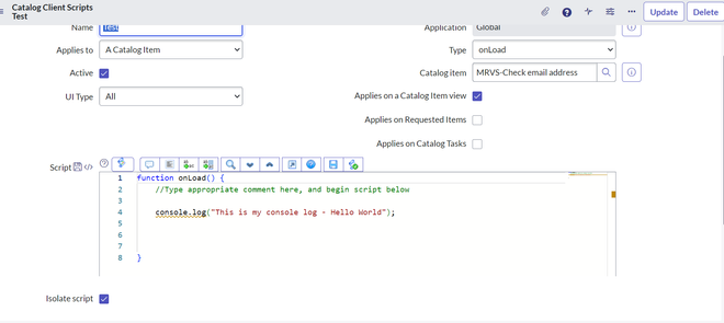

Hi everyone, I have created a new catalog client script. However, it does not work even though I am just logging in the console. I have checked and not other UI policy runs to counteract this. I will attach the script here.
ps. it works once if I trigger it multiple times

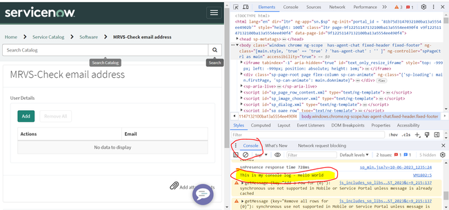

Console logs also works...You have to check that in browser console actually like below :
This is my script :
To check browser console >> Right click on page >> Select 'Inspect'

The ending brackets for the onchange function is present, I just couldn`t show in the screenshot
