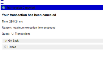

After some development in a catalog item, while testing and creating a RITM, it does not load at all and is being cancelled with this message:
Although after reverting the development I did, same issue is happening.
How can I check what is causing the issue ?

Yes the error happens after submitting the catalog item on service portal.
The REQ is being created, and the RITM as well (I can see it in the sc_req_item table). However it is impossible to open it.
Indeed the catalog is using a specific workflow and also flow.
Yes I removed all modifications I did, basically it was just adding 2 variables and 1 client script...
I noticed the same issue is happening in POC environment, where I did not implement the modifications above... Only thing I did in POC was adding one MRVS.
